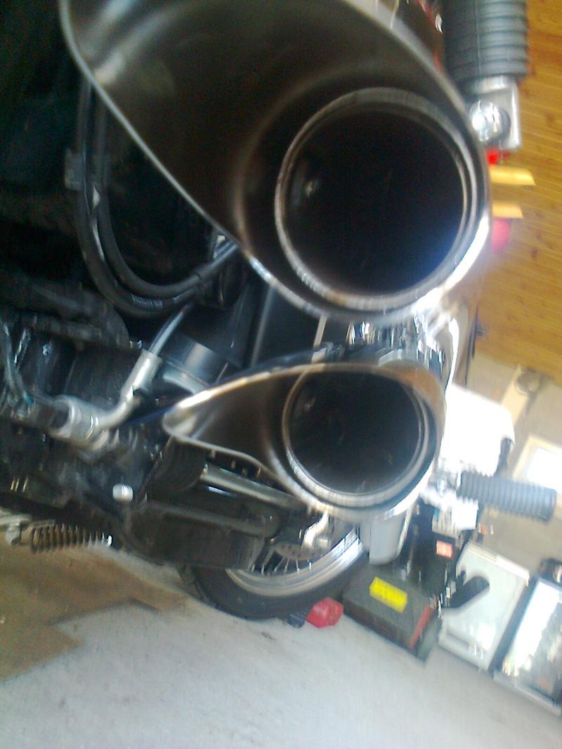

une petit photo des chicanes US d'origine qui ne servent à rien Okay

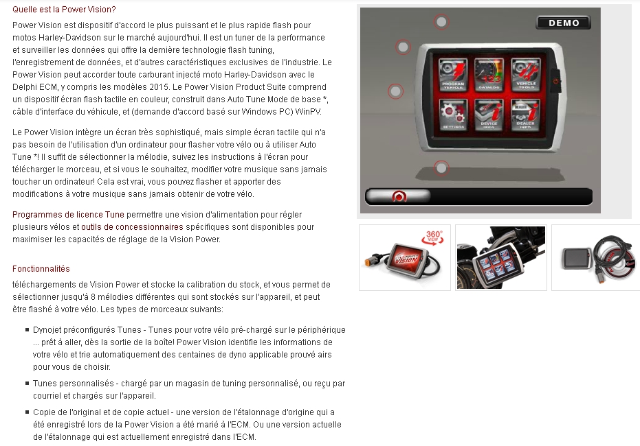

bon je me suis renseigné pour un boitier carto stage 1 : Dynojet Power Vision
- Harley Lyon = 520 (faut aller le chercher)
- Big Twin City = 483 (avec code reduc fofoxl)
- Acab Import = 439 port gratuit
- Sylverperformance = 409 port gratuit
Ven 10 Juil - 17:34 (2015)
celphi
Inscrit le: 09 Juin 2012
Messages: 2 701
Message Dyna 103Ci Low Rider Répondre en citant
j'ai envoyé hier soir un mail à dynojet et ils viennent de me répondre en me donnant le fichier attaché à injecter dans la carto
pour une configuration optimale pour mon Low Rider avec avec filtre figure machine vision 5"et pots V&H big radius
c'est le top leur service développement
et en plus ils ne m'ont même pas demandé mon N° de client ou le N° de série de mon boitier powervision
Ven 10 Juil - 18:56 (2015)
celphi
Messages: 2 701
voici leur mail :
Philippe,
Thank you for your support of our products. Attached to this email is a tune that is the closest starting point for that motorcycle that I currently have available. It is always the best idea to have a custom tune built by a local tuner.
To take this a step further, we offer professional tuning tools that are now embedded in the Power Vision. Let’s face it, there isn’t another person on the face of the earth (dyno tuner or not) that’s going to spend more time your bike than you.
We’ve released (2) different versions of a process that helps tune your bike:
Auto Tune Basic (free and requires no additional parts for bikes with factory closed loop o2 sensors)
Auto Tune Pro (not free, this requires the use of our Autotune module that has (2) wideband 02 sensors)
The main difference between the two is that Auto Tune Basic uses the factory narrowband o2 sensors, so essentially you don’t need to add any additional modules or sensors, while Auto Tune Pro uses a Dynojet Auto Tune device which utilizes a control module and a pair of wideband o2 sensors.
In either case, this is how it works in a nutshell (and works VERY well I might add!):
Power Vision will “set up” the tune like a professional tuner automatically without the need to interface with your computer
Power Vision will automatically log the required data.
Since the H-D data bus broadcasts “desired AFR”, or “Set AFR”, the Power Vision will look at this along with the other required data channels like MAP, RPM, TP, wide band Lambda 1 / Lambda 2 (if using Pro) narrowband AFR (if using Basic), and front and rear VE.
In the end, Auto Tune automated the tuning process and made corrections to the VE (volumetric efficiency) tables to fix the error between "desired AFR" and "actual AFR".
You can now set the AFR or Lambda table to values that are best for your bike and those AFR’s will actually be realized.
If you have any questions, please feel free to contact us... We're open Monday-Friday, 9am-5pm Pacific time.
Scott Webster
Technical/Sales
Dynojet Research, Inc.
2191 Mendenhall Dr., #105
North Las Vegas, NV 89081
phone: 800-992-4993
fax: 702-399-1431
