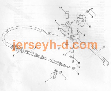

Don Long Juan
Inscrit le: 01 Déc 2012
Messages: 4 867
Localisation: Pyrénées
Message jeu poignée d'embrayage Répondre en citant
Une petite image...
2 WASHER (2)
Part No: 6101 All Models £1.03
3 LOCKWASHER
Part No: 7145W All Models £0.51
4 CLIP
Part No: 10123 All Models £0.69
5 RETAINING RING
Part No: 11143
Superseded part nos: 11279 All Models £1.03
6 O-RING
Part No: 11179 All Models £0.97
7 BRACKET, clutch lever
Part No: 38608-96 All Models £20.00
8 CABLE ASM
Part No: 38662-00 HUG / 883C / 1200 £36.50
8 CABLE ASM
Part No: 38663-00
Superseded part nos: 38619-00 STD / 883R / 1200C / S £36.50
9 BOOT, clutch cable
Part No: 38630-88 All Models £4.12
10 HAND LEVER w/ #45021 -86, 45423-92 & 90770-79
Part No: 45015-96
Superseded part nos: 45017-93 All Models £40.00
11 SPRING, anti-rattle
Part No: 45021-86 All Models £2.06
12 PIVOT PIN
Part No: 45032-82 All Models £6.75
13 CLAMP, clutch control
Part No: 45044-96A
Superseded part nos: 45044-96 All Models £7.75
14 PIN, clutch cable
Part No: 45036-88
Superseded part nos: 38638-96Y All Models £2.18
15 BUSHING
Part No: 45423-92 All Models £2.50
16 SCREW, spring - clutch lever
Part No: 90770-79 All Models £1.03
=> Le 8 carbu alias El Viento
=> Le Gros Bob
Mer 19 Aoû - 12:23 (2015)
Messages: 28 644
Pièce 11. Wink
